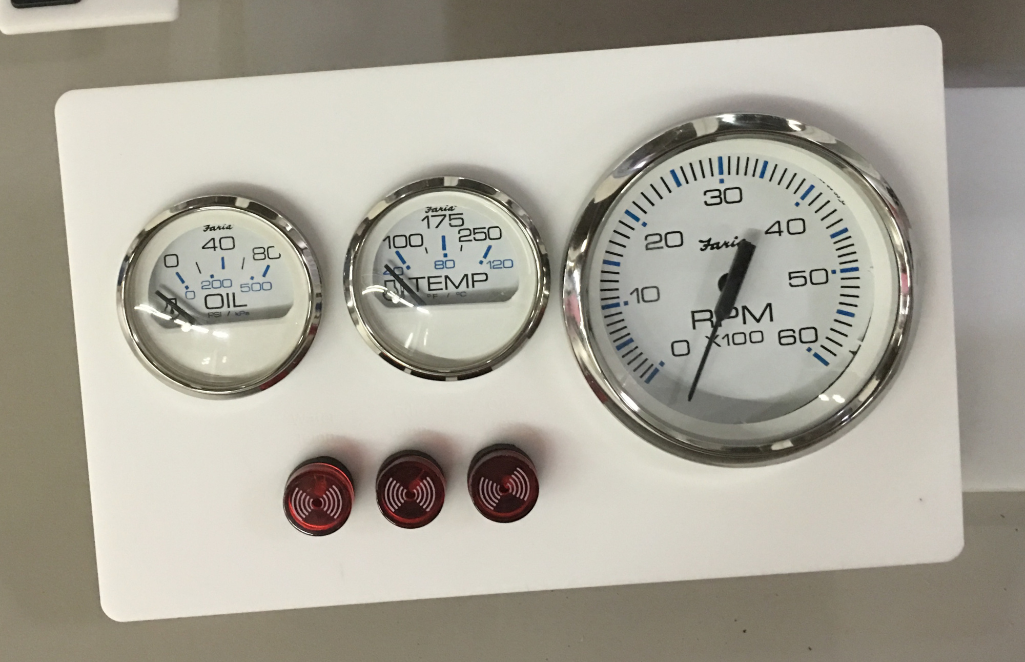

Me too. I added alarms for exhaust temp, oil pressure and water temp. I decided to use Faria gauges on white quarter inch mat acrylic. I still need to fill in the etched labels so they are readable.
