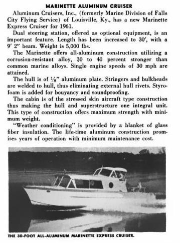

Some Specs
Motor Boating 1961 - 30 Foot Marinette Express Cruiser Overview - Qtr Page.jpg

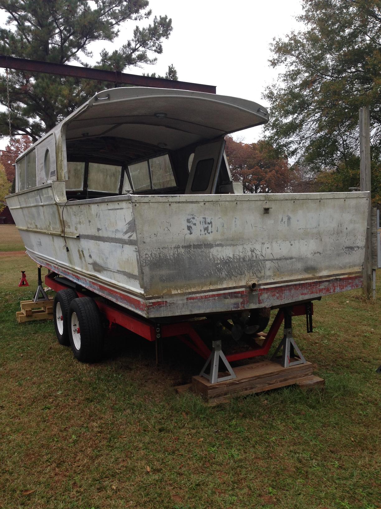

Some more views of the 59 on its trailer. This is a single prop.

Clarification ,
Hauled my 59 28 footer with twin 3500lb axles without an issue so 6500lb axles should be overkill since I use those to haul my 63.
