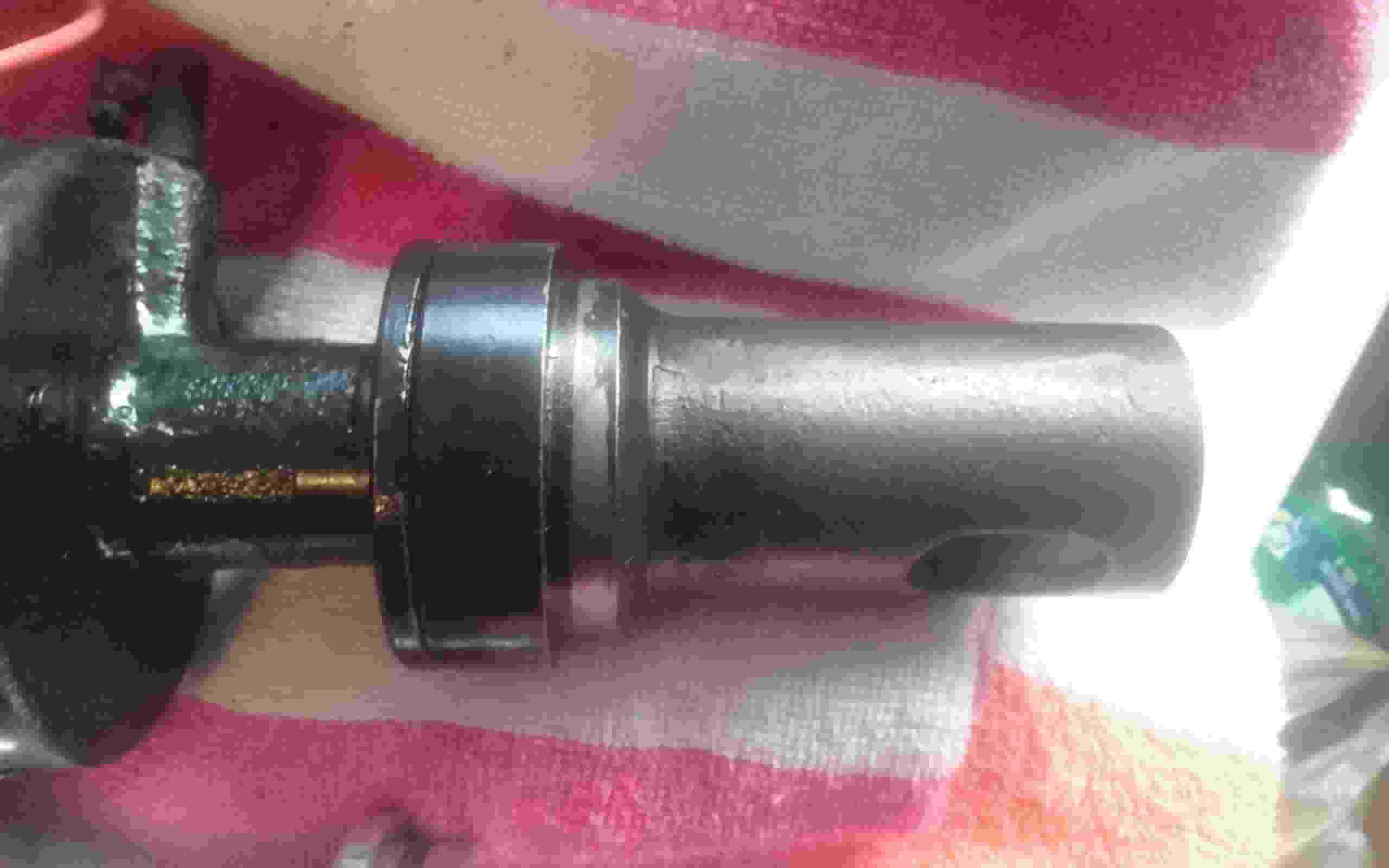

I agree firing order and the spacer under the distributor is a quick way to I.D. them not running.
