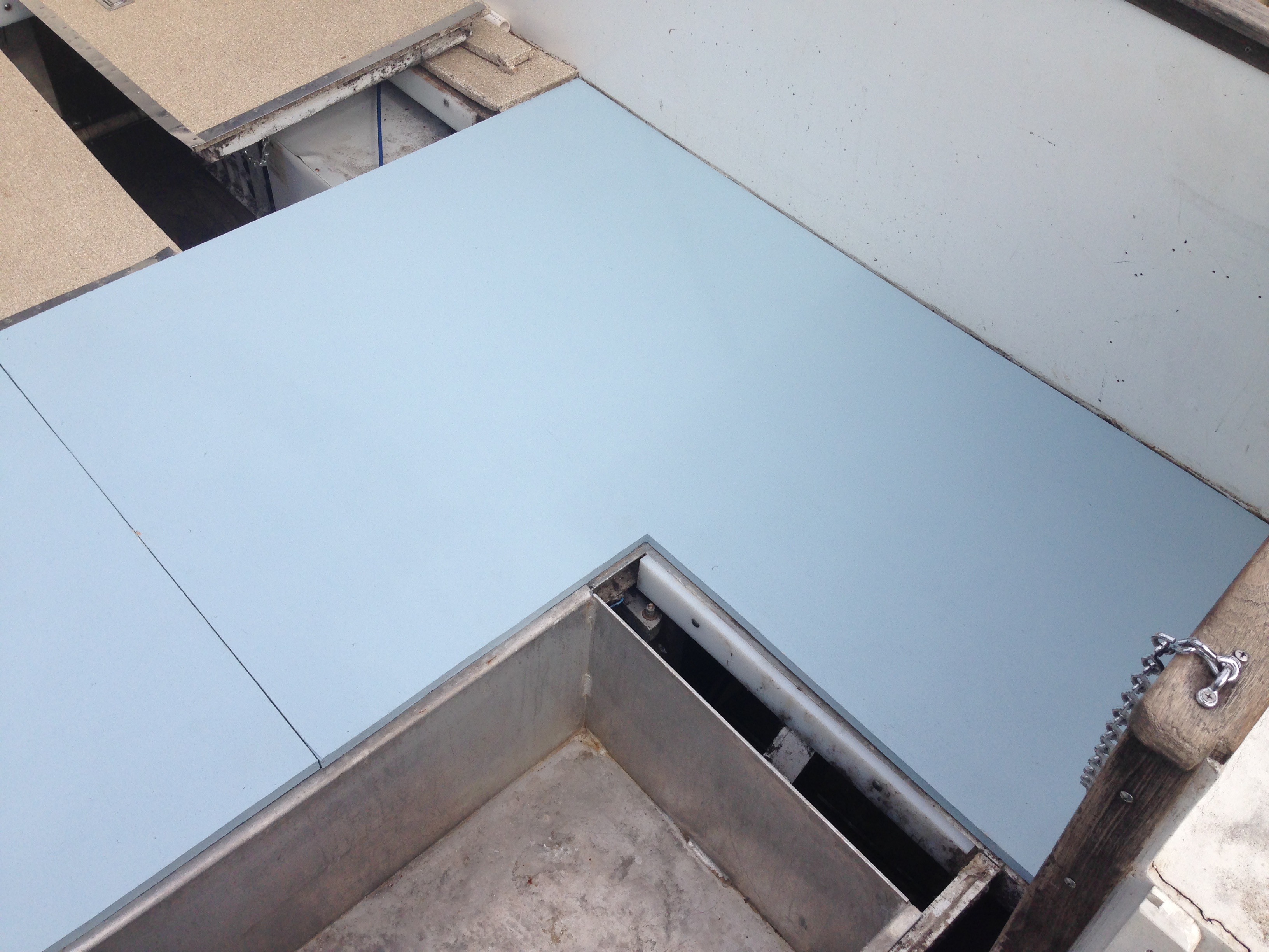

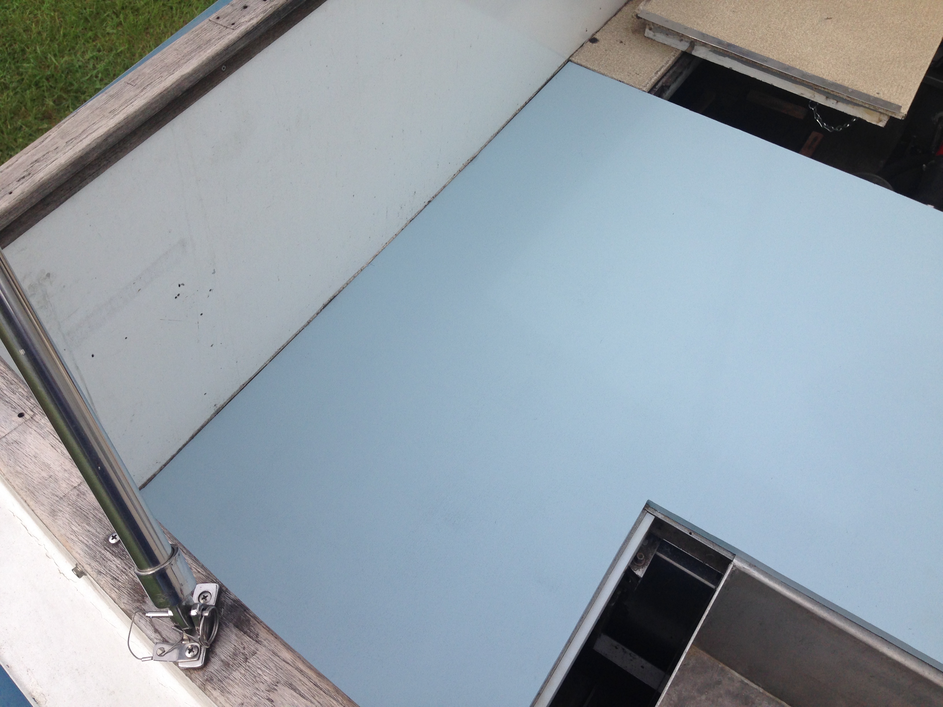

I am 260 lb and do not think my original 5/8" decking feels at all springy. I have replaced the hatch and the section forward of it thus far. My hatch had gotten rotten and the section in front of it was beginning to sag in the middle over time and held water. in a pool. I need to do the three remaining sections still, they are not soft anywhere but have holes from mounted fishing chairs and down riggers.

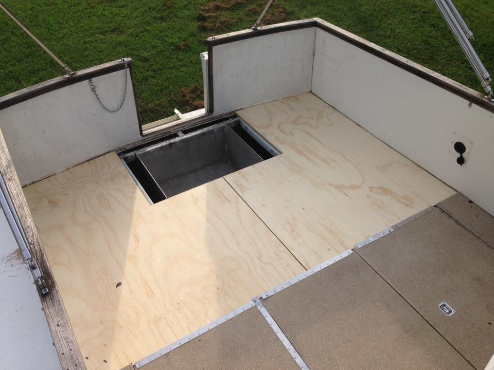

Cut new plywood decking from 5/8" exterior plywood. Had a pickup bed sprayer spray and underlap the bottom side by 6". Replaced the big washer on the cockpit drains with a big 1/4" aluminium flage that fits under the corner side walls. Tighten the cockpit drain nut and the deck is tightened down in the corners. Only put back the under deck screws I could reach.
