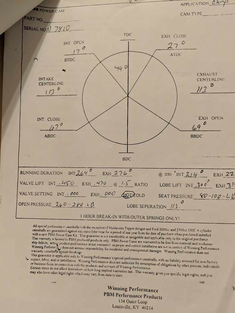

Not sure if this helps but here are the rebuild specs.
