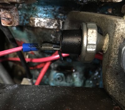

I have an oil leak at back of motor. It looked like it was coming from inspection flap on bell housing.
That's bad as I thought rear main seal.
I just found that oil is leaking from an oil sending unit. I used this cheap endoscope that hooks to my phone to find it. I recommend these things.
That's good compared to the rear main.

That seems like an unfortunate place to have an instrument! I have a Carter that is kind of like that except it has three connection prongs. Mine is on top of the engine. It's a go/no-go for the retrofit electric fuel pump. No oil pressure, no fuel pump.

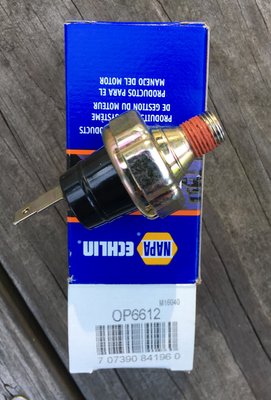

Very common for these sensors to leak. (Have replaced several myself) They are a common item at NAPA. They made two a long one and a short.
Buy the shorter one if at all possible! I keep a couple of spares on the boat. The long one is a tight fit it gets in the way of my Distributor on the port engine. Your photo shows the short one.

Thanx for the help. Got one & it will be installed shortly.
