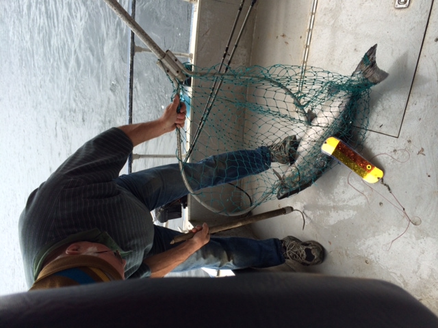

I am very happy having aluminum on my deck. Can't find the pictures I have of the deck, but you can see some of it here. Mine is one big piece which makes it hard to remove, so I would recommend installing it in a couple of pieces.
