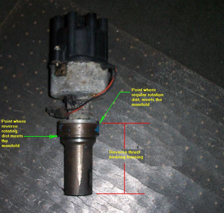

Re: reverse rotation engines
Does this look the same as the normal rotation distributor?

bobv
Posts: 39
Joined: Sun Jul 13, 2014 4:31 am
Post by bobv »
Pull that collar off it is the exact distributor. That collar is not part of that distributor you must reove it and use it on the new distributor.If you can find a part # for this so called reversing distributor please share it .
You can check with every manufacturer the cw and ccw motors use the exact part #. I know I have done my reserch.I have also pulled the distributor off the cw motor and put it on the ccw motor.They are the same!!!!
Again if you can find a part # that is different for a reversing distributor,please share it.I assure you that you will not find one because it does not exist.
Btw the gear on that distributor is exactly the same as the other one.
