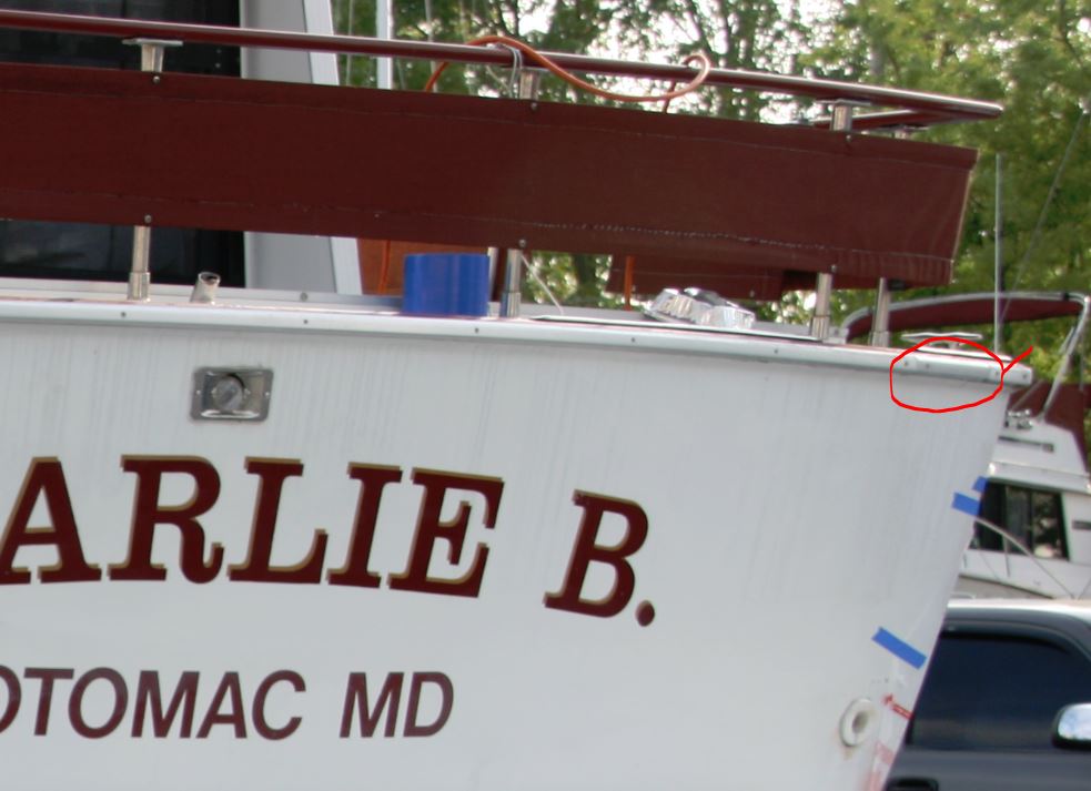

Hello Aluminum Cruiser owners. We purchased a 1978 Marinette flybridge with a single 318.
Love the boat. When we tried to get it registered county clerk said we need a rubbing of thevin number or hull number. Can anybody tell us where that number is located?
diFrenzi in Kentucky
Posts: 901
Re: Hull or vin number...
The vin/hull number (it's actually called HIN, hull identification number) required to be attached to boats was on or just below the stern rub rail. It was a required tag starting for boats made after Nov 1972. Pretty sure this photo with the location circled is accurate. I believe the number started with letters ALC for Aluminum Cruisers

That's where mine is too.
