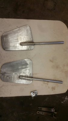

The only boats I have ever seen with aluminum rudders are sailboats and kayaks. I would be willing to bet that a powerboat would bend the rudder stock over time from the prop wash if it was sized the same as a steel rudder. When I made my SS rudders, I used pieces from my old prop shafts for the stock and cut out some 1/4" thick plate for the blade. One of my customers is a fab shop and they welded the whole mess together for me. Best upgrade to the boat. What size rudder stock do you need? I know I have a few 1" shafts laying around and I have either a 1 1/4" or 1 3/8" shaft on the shelf.

EWRice wrote:The only boats I have ever seen with aluminum rudders are sailboats and kayaks. I would be willing to bet that a powerboat would bend the rudder stock over time from the prop wash if it was sized the same as a steel rudder. When I made my SS rudders, I used pieces from my old prop shafts for the stock and cut out some 1/4" thick plate for the blade. One of my customers is a fab shop and they welded the whole mess together for me. Best upgrade to the boat. What size rudder stock do you need? I know I have a few 1" shafts laying around and I have either a 1 1/4" or 1 3/8" shaft on the shelf.
OK, I'll go with SS.
