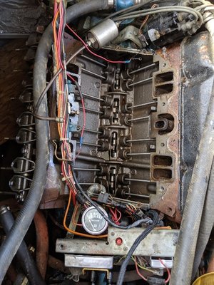

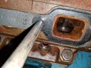

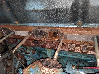

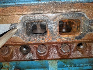

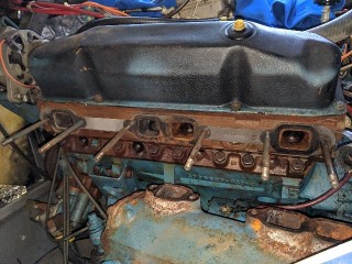

Pics of head after exhaust manifold removed. Was hoping to find a blown gasket or leaking gasket here to answer my question of why liquid in the spark plug hole closest to the riser. If anytime has any thoughts on the condition or if the gasket appears to have leaked I would appreciate the knowledge.
1978 37 Double Cabin
Lake Cumberland KY
Re: Exhaust manifold removal
It is entirely possible that leaking (cracked or rusted through) exhaust manifolds or the riser could have allowed water to get in there and do all that damage. Or, you might have simply had a leaking gasket.
If you don't want to waste money on new parts (since they might be not be needed) you could try the following test:
Reassemble the motor with new gaskets (with a thin smear of silicone sealant on EACH side) and see if that cures the problem. Drain the riser and manifolds SOON as you shut the motor down, to eliminate a leak from getting in there. If the motor runs okay after restarting the next morning, repeat the test, but this time don't drain the manifolds. If it still runs okay you might have had a gasket leak--it happens. If not, it's new parts time.
Good luck!

Jeff- thanks so much for the ideas on testing. I am thinking about trying to plug up the passage as well as I can and using g something to get the rust out of it. I was also going to clean all the rust off of the face where the manifold mounts and try to make sure I have a clean flush face for mounting with new gaskets then attempt your recommended test. If the test fails what "parts" am I looking at? New riser and manifold, heads, etc?
Lake Cumberland KY
Risers and manifolds.
Good luck!
