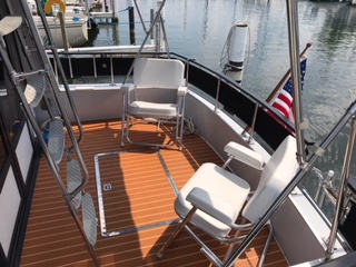

I used 5/8” marine grade plywood and covered with “Lonseal” vinyl covering, holly and teak pattern.

I really like that. How did you seam it? Looks like it the widest it comes is 8 Ft rolls?SunbeamIV wrote:I used 5/8” marine grade plywood and covered with “Lonseal” vinyl covering, holly and teak pattern.
