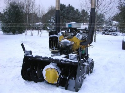

Re: Starter Bendix
Neat idea, but this is what you really needed.
