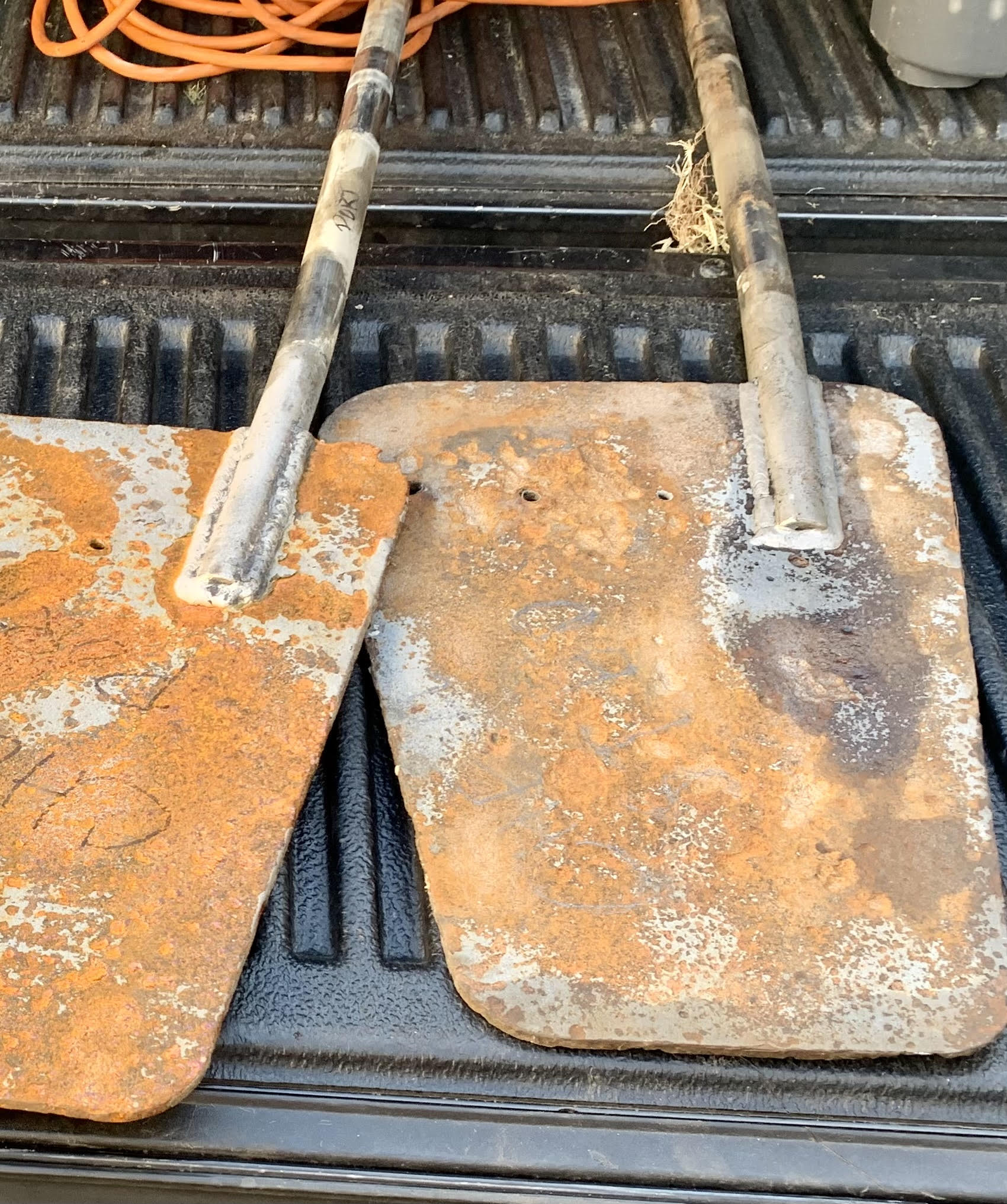

I removed my rudders from my 1990 32 Sedan to have the steel upgraded to stainless.
The shafts are bent- both appear the same. Is this correct, or did I hit something (they have operated fine)? I hope you ca see in the pix:

On my 32' and 37" the shafts are straight. Both 1975 boats. :)

Shafts are supposed to be straight.

It goes without saying but be sure to duplicate the shape of those rudders close as you can.
A lot of engineering goes into those to make the steering (which if excellent on Marinettes) work that well.

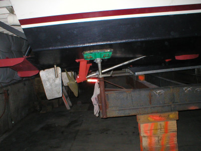

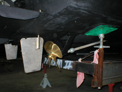

I found a few pix of my former boat's bottom and, while the angle I observed isn't really great, it doesn't seem to show a bend in the shaft. How both of yours would be bent is rather mysterious especially since you don't recall hitting anything.
I do recall that the blades were pointed a bit off center for a reason (to improve steering, I think) but I could be imaging that. It's been a while since I boated.
