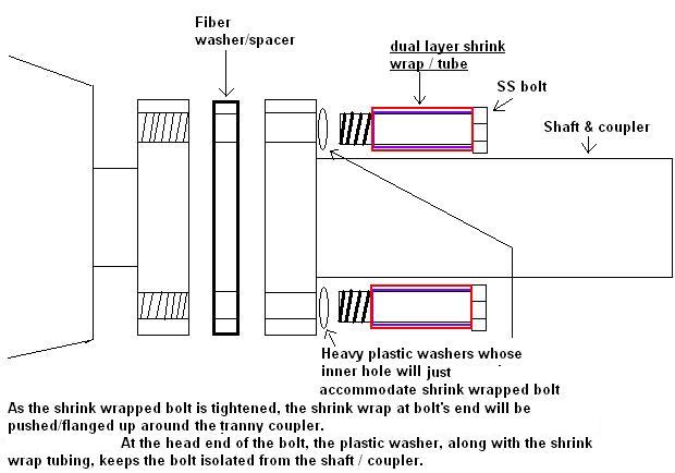

Re: prop shaft isolation help. Drivesaver not an option
For washers you can make them easily from bleach or other poly bottles. Cut a flat piece out, drill or punch center holes and punch or use scissors for the outside circle. Make some extra. You can make them faster than you can go to the store. After you put it together, test with ohmmeter set on low scale ( about 0--100 ohms ) in or out of the water. Then check every year before you put it in the water.
Posts: 536
I did what Collins69s suggested with a bit of "overkill". Used SS metric bolt and doubled up on shrink tubing. Felt more comfort with 2 layers of shrink tubing in place. Test for continuity each year and all's good.

Do your bolts thread into the flange on the transmission?
1973 Marinette Seacrest Executive
41x14
Twin Chrysler 340's with Velvet Drive 71C
"Figment"
They are usually nuts and bolts.
jtalberts
Posts: 133
Joined: Sat Jul 12, 2014 7:30 pm
Post by jtalberts »
coupler passes the bolts through but they screw into the flange. Makes the heat shrink impossible.
