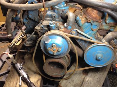

I am not sure that is the case here. Here are photos of both the port and starboard engines I took before I disassembled everything and the orientation of the pumps are the same. Any ideas?

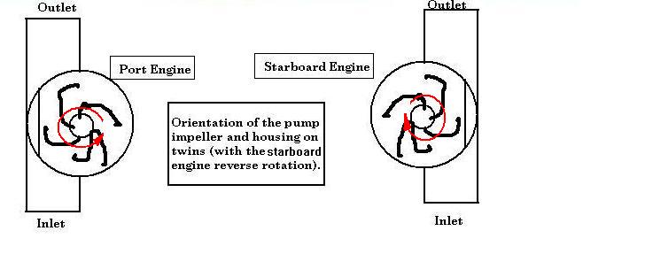

I'm gonna try to upload my sketch of which way everything goes. This site has tight restrictions on file size, so it might not work.
Here goes...

This is a diagram of the raw water impellers, right? I am talking about the fresh water pumps bolted directly on the engine block.

Yes. Hoses are not reversed. Direction of vanes are.
Follow Jeff diagram it is perfect.

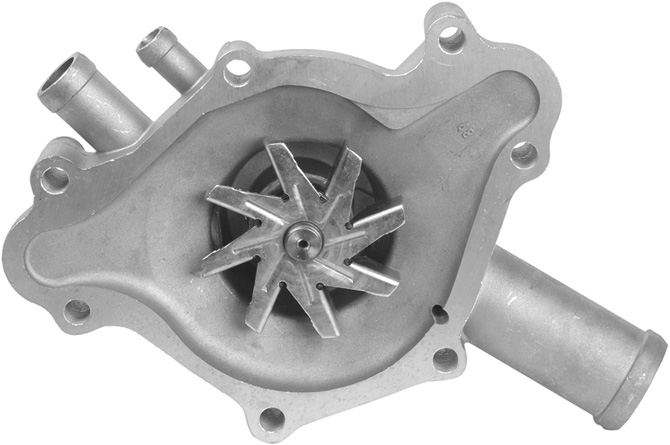

The fresh water pumps on marine engines are not directional (same pump for regular and reverse rotation motors). The vanes are straight. A car water pump is directional, though. See the images
