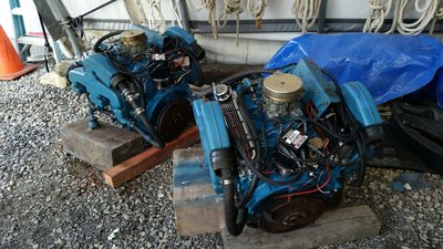

Well I am considering Atlantic Marine Store long blocks, either the 318 or 360 for the same price. They have a two year warranty. I have sent them a long list of questions. So I am still pondering this option. Do not know the torque rating yet. The Velvet Drive transmissions c-72's are rated at 495 ft lbs. Of torque in our boat so they will handle it. The props will probably require a more agreesive pitch or new ones. The 318 stroker they offer has 9 to 1 compression and it uses the cam from a 360. There is no core charge or exchange required. I would also consider a different valve tappet arrangement.
Michigan motorz has a mercruiser 383 stroker 340 hp rebuilt 350 block carbureted with lots of nice features but they cost $19,000 bucks with a three year warranty. Our transmissions would work and they do have a reverse rotating motor.

Unless that motor is going in a Go Fast boat, you'd be far better off with a stock 360. Torque (not hp) is what makes the difference between an economical cruising motor, not one that has to have the snots reved out of it to maintain plane. (My old 32 footer with 360s would hold plane down to 2,000 rpm with a full load--and after making a full lock 360 degree turn! That's low speed torque.) The 360s--with their small ports and valves--is ideal for a cruiser.

Atlantic Marine Store in Hialeh,Fl. Told me they do not recommend the stroker motors for marine use. So the 318'!s will be rebuilt to as close to stock as possible. May upgrade the valve train tappets.

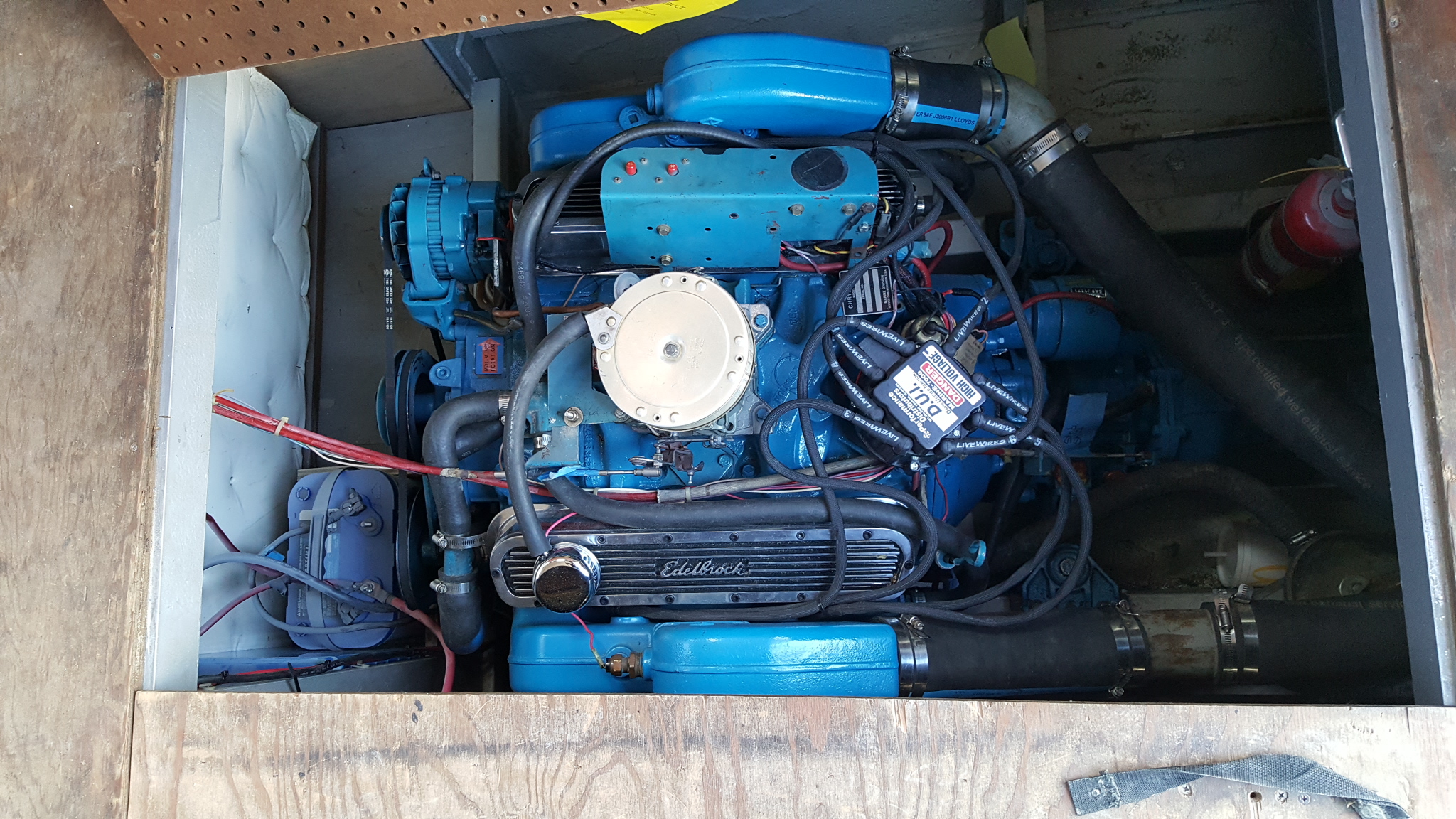

Okay guys,against all this talk my 318's are 390 cu.in. stroker motors with 350 h.p. preliminary testing at 4300rpm she was running 33mph. No generator installed during test. Red line is 5800 rpm. She needs more fuel so we are installing Edlebrock 750's. Test putt for us on the Tn. RIVER is May 6,7,8. One year warranty. She planned at 2300rpm.
