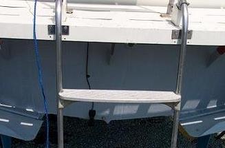

I drilled a couple of holes and sheet metal screwed it to the transom (with silicon on the threads). Piece of cake!
PS: Remember, you'll need an extension cable to reach the helm.
- Attachments
- Swimladder.JPG (11.55 KiB) Viewed 23564 times
