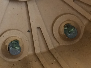

That's one of the things pertronix tells you to take out. Mine never had one with the old setup so its not an issure. I did keep it in on the friends boat just to see if it would make a problem and so far 1st year on his everything still running strong. Here is what the cap looked like I really think my problem is moisture.
